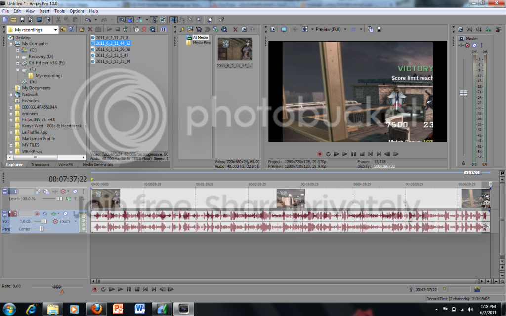

    So im having a problem with vegas, After im done recording with my HD PVR, (hauppauge)
    I want to edit the video with vegas so i open it up and only the upper left corner is showing in the preview display. I tried to render it anyway and it rendered only the top left still. I opened the original file in windows movie maker and it loads fine no problems or when i play it with windows media player everything is fine. Heres a pic.
    https://i1194.photobucket.com/albums/aa363/Michael_Pousada/needhelp.png

  • John Rofrano
    June 3, 2011 at 12:00 am
    Hi Mike,
    You have your preview set to Full. Right-click on the preview window and select Scale Video to Fit Preview Window. Alternately set your preview to Auto. Either of these should scale the video down for you.
