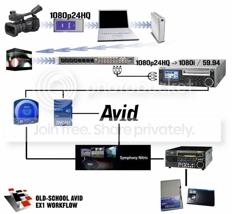

    Looking for input on this silly application of older offline/online mindset to PMW-EX1 workflow. Project is spec and out-of-pocket. Stretching this offline edit over older Avids (non 24p). Notice any faults with this recipe? Other than the obvious (why? spend some money, get editors newer Avids, etc.).
    Final deliverables: HDCAM 1080i / 59.94
    Acquisition: PMW-EX1 1080 / 24p {HQ mode – 35 Mbps}
    Media move: SxS -> laptop -> firewire drive -> desktop FCP
    Pre-edit CONVERT: FCP Selects -> ADD pulldown -> Sony PDWF70 {XDCAM HD 1080 / 59.94}
    DV Clones: XDCAM HD -> DV
    Offline Edit DV
    Online: Nitris relink to XDCAM, sweetened audio insert, colorist prettiness
    OUT to – HDCAM
    I realize this is completely bizarre. Even if only in theory, why wouldn’t this work? Any and all input appreciated…..

    Going down to DV and then trying to boost it back up to HDCAM is not a good way to go.
    You don’t even need a raid to edit EX-1 files. But, you do need a version of Avid that will work with the native files. The DV codec is a horrible thing. Horrible, I said. Don’t go there.

    Why go DV and adding pulldown etc- sounds needlessly complex. When you could just cut native super simply in 24p XDCAM EX in FCP and then bump out an uncompressed 1920×1080 QuickTime MOV all ready to push out to HDCAM or sweeten in Nitris or whatever. 35 Mbit as a format is arguably “offline” right in the camera to some folks at least in terms of storage requirements.

    As mentioned in the subject heading, this is addressing an ‘old-school offline / online’ scenario. I have all the gear to handle XDCAM EX – no problem. Final Cut 6.0.3 and Media Composer 2.8.3 (still haven’t tested that CPR yet). However – I am not cutting this project. The lead editor is in a remote location with an older Avid. Pulldown will need to be added (at some point) to get to 1080 / 59.94 for the broadcast deliverables. A 1080/23.98p master is not an option here.
    Imagine it as a tapeless workflow with the archive in the middle rather than the end of the project. Camera files get selected and dumped to XDCAM optical disks with DV clones. His DV Avid offline creates the EDL for the XDCAM -> HDCAM Nitris online.
    Like I said ‘totally bizarre’ but could it (theoretically) work? And, no, Final Cut will not be considered for any part of this equation other than building the camera selects reel. I’d invite you to that debate with this editor but I seriously doubt you want to go down that road with this guy.
    Bizarre? Yes. Feasible? Maybe….

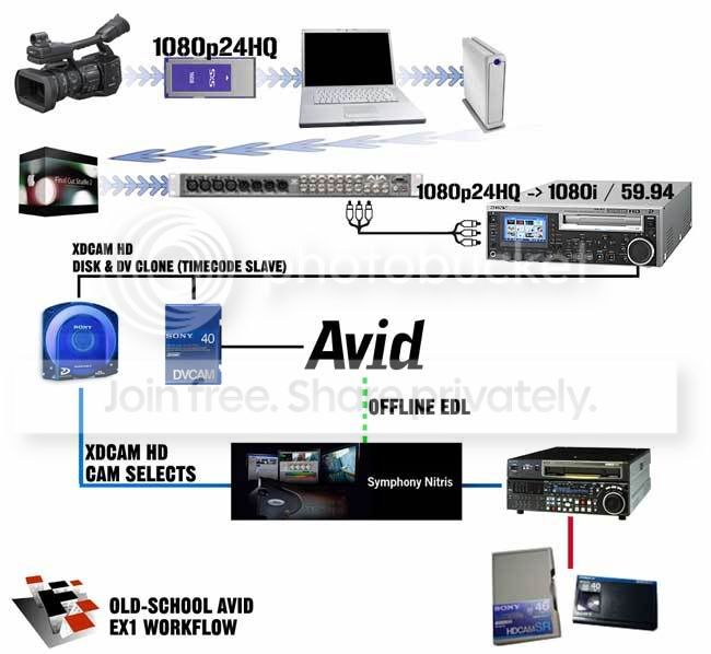

    {REVISED jpeg}

    Thankfully I personally will never have to jump through so many hoops just to please a set in stone editor guy. 🙂 But on the surface I don’t see anything technically unsound with your workflow. Surely though there must be a couple of dubs and steps you can remove just to get him something to edit not to mention to save a lot of extra reconform time at the end.

    Understood. And – thanks for checking it out. Maybe the diagram exaggerates the steps too much. When all’s said and done, it’s not overly complex. End result will come out with archives on XDCAM HD disc with DV dubs and a HDCAM show master.
    A PDW-F70 is around $700/week here versus $1,000/day for a Sony ‘real’ HD deck. Plus, you save money in that it can be cut on just about any ancient NLE (with no upgrade costs on his end).

    There remains some confusion on your end. The DV is only used for the offline edit. His EDL will be used for the HD online. No DV will be bumped up or up-rezzed. Hence part of the subject title: “Old-School Off/Online”.
    Shoot files get archived to XDCAM HD disks and timecode-slave DV dubs. He cuts the DV on his older system and spits out an EDL. I walk into a Nitris bay with the EDL and XDCAM disks and walk out with a HDCAM master. Again – we’re not bumping DV up to HDCAM.

    Why not dub the XDCAM footage to HDCAM @23.98 and then use the HDCAM deck to add pulldown uppon capture?

    I was thinking of saving a little money…. The XDCAM is already compressed in that format and a HDCAM deck is $1,000/day rather than $300/day for an XDCAM PDW-70.
