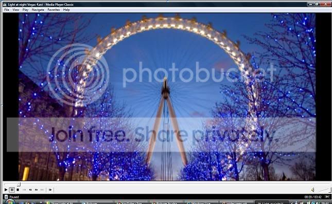

    I’m doing a music video at the moment. i did a rough render a while back, which was true widescreen and it had black bars. that looked like this vvv

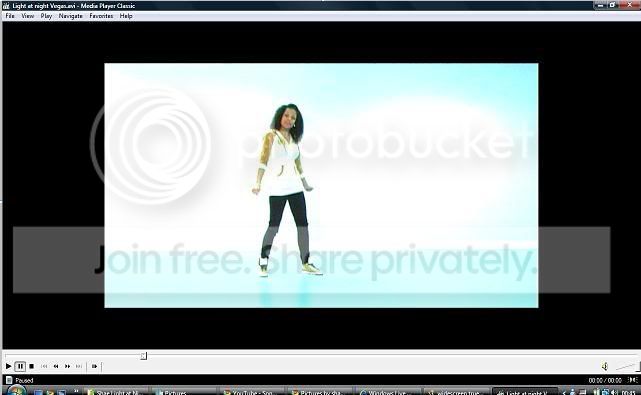

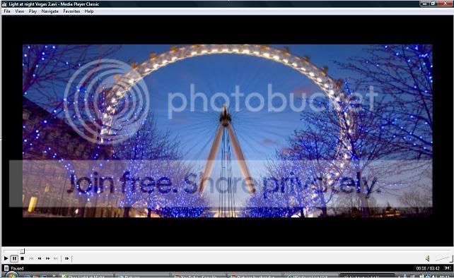

    now when i render it either ends up like this 1) full widescreen or 2) letterboxed. Does anyone know how to make the footage like the 1st photo?? would be so thankful.
    1)
    2)

    I imported from miniDV. the format is DV Pal Widescreen (and AVI File). I want to render it back out as an DV Pal Widescreen, but with those black bars that are shown in picture 1 (like the bars you see on music videos and feature films). I must have done it but i cant remember what i did to make it like picture 1. now when i try it only ends up as picture 2 (the original formal) or pic 3 (letterboxed and 4:3)
    The preview window shows it as the second picture (the original format)

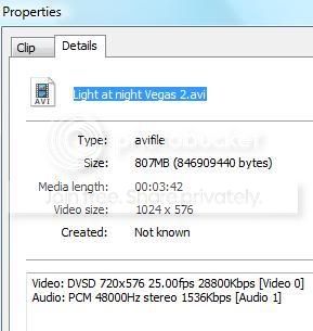

    Dont know if this will help, this is on the properties when i right click on the media player for Picture 1.
    Go into Pan/Crop and hold the Ctrl key while you drag the top of the frame down to whatever wide aspect you’d like the video to be. (Ctrl overrides Lock Aspect Ratio)
    If you want to squish the video like you did in the top picture use Track Motion instead and disable Lock Aspect Ratio before you change the size. The video will squash into whatever aspect you’d like.
