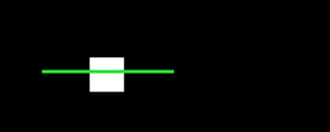

Posted by Navarro Parker on October 10, 2012 at 12:22 amIs there any way to base layer’s rotation on another layer’s velocity? The faster a layer moves, the more the other layer rotates.

October 10, 2012 at 2:04 amyep… pretty much any key framed property will have velocity or speed, so an expression like this could be used to link one layer’s velocity to another’s rotation:
L = thisComp.layer(“square”); // this is your square layer, or layer to take velocity from
L.transform.position.velocity[0]/50;the expression looks only at x position, to look at y, change [0] to [1]; or z, change to [2].
the 50 can be changed to any value to get the amount of rotation you need, 50 was kind of arbitrary on my end

October 10, 2012 at 2:16 amI think this is what you’re asking for, but I doubt that it’s really what you want:
factor = 50;
vx = -thisComp.layer(“leader”).transform.position.velocity[0];
vx/factorMy guess is that you’re really looking for a more complex simulation that is based on acceleration, inertia, and overshoot.

October 10, 2012 at 6:50 pmThat works amazingly well. But you’re right, I would like to soften out the rotation a bit. Would adding overshoot and dampening be overly complicated?
