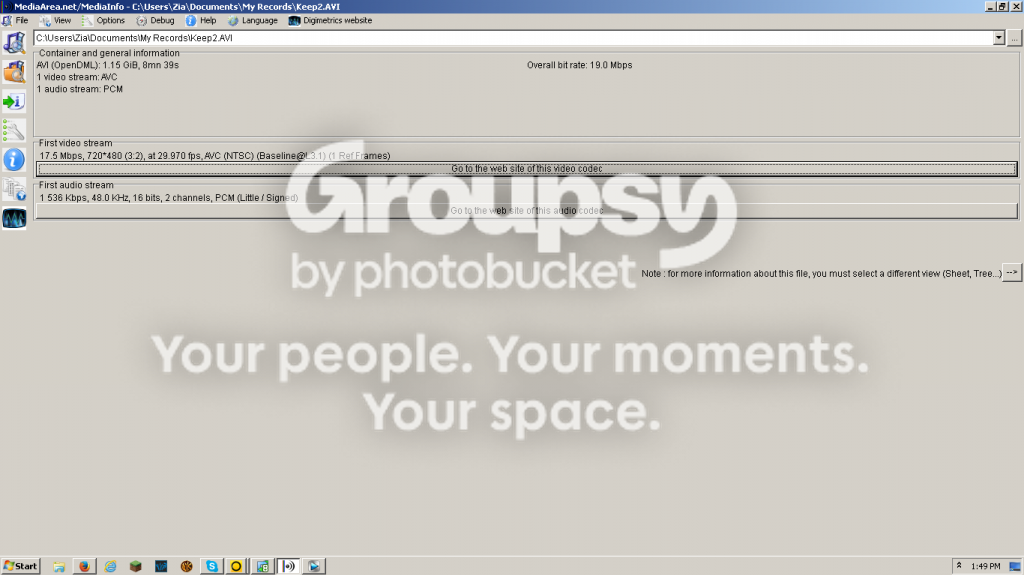

    So I recently downloaded sony vegas pro 12, and i’ve been wanting to edit some videos but it says and error occurred while opening one or more files and or opening a codec, so I read up on it and people said download mediainfo for the codec needed, so I did that, and this is what came up: https://i1225.photobucket.com/albums/ee391/minecraftplayer1024/Photo.png
    It’s a codec called videolan x264 and I downloaded that but it’s just a bunch of files, is there some place I need to put it?
    Please help.

    I looked at that MediaInfo info and I didn’t see the need for anything “Videolan”? Where is that?

    And i clicked to go to the codec on mediainfo and it took me to a videolan website, I don’t really know how else to explain it, and with vp12, I researched it and it’s some form of computer chip?

    You need to install an AVC codec for Video for Windows. x264vfw might be a choice, but I have read reports that it is not actively developed and is quirky. AVC in an AVI file is unusual.
    For AVI files, Vegas goes through the Video for Windows subsystem. This is an extremely old subsystem, depreciated since 1996. So anything, “new” like AVC you are going to need to install Video for Windows codecs to get it to work in Vegas. Vegas has AVC codecs but they are not used in Video for Windows files.

    VideoLan is the organization that makes the VLC player, which can play pretty much anything because it does not rely on system codecs.
    James, by any chance is that .avi some kind of a screen-capture file, using something like CamStudio? From a game? Sometimes those files are so compressed that Vegas and other NLE choke on them.
    Opionions differ, but I don’t think AVI is the best container for OpenDML or x264.
    Sorry I can’t offer more. But I agree with Graham – don’t screw around with codecs. You might try converting the file into something less compressed.
