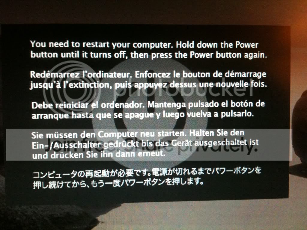

    I put the SxS card in my macbook pro and the following error came up:
    This error came up before a long time ago when I used my 8GB SxS card that came with my EX1 – working fine, then one day this error. I switched to a Kensington adapter and transcend card and have not had a problem since. That is until now.

    The kernel panic on your Mac may be an unrelated issue. If you have Snow Leopard (10.6) and the older SxS driver this is normal. Upgrade the driver to 1.04 or higher (current = 1.05).
