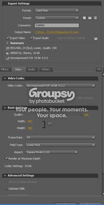

    Everytime I try to export a file it either exports wrong (posterizes ny movie) or gives me errors.
    I want to export my film uncompressed. I tried setting the video codec to “none” but it posterizes (or really it desaturates it and adds random splotches of color). I then tried using Uncompressed YUV 10bit, it rendered once nicely, but I realized an error I had made in the video, fixed it and tried again only to recieve error after error after error. It doesn’t even tell me what the error is as far as I can tell, it just gives me the yellow triangle with an exclamation point in it.
    I tried recreating the project, but it still isn’t working.
    Below is a screengrab of the YUV settings.
    https://i19.photobucket.com/albums/b168/Erailea2/grab.jpg

    February 23, 2010 at 11:49 am
    1. Really strange output resolution; 853×480. Not sure what your target is but resolution should be divisible by 16.
    2. Quality setting of 100 can actually compromise smooth motion.
    3. Your output is interlaced…no TV can handle your resolution.
    Suspect #1 is you main problem.
