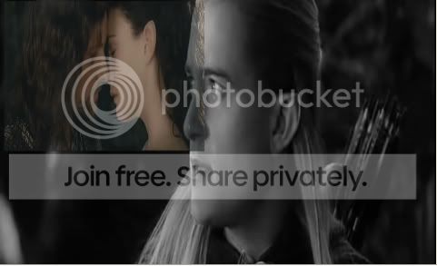

    1) How to speed up an event/separate video file?
    2) How to make the event on the other track that being put agaisnt the background event to be transparant on all edges?
    It should be smoothly incorporated.
    See the pic and don’t laugh :]]]
    https://i46.photobucket.com/albums/f108/Nefariouslash/Vegas_pic.jpg

    2. Does the top image have an alpha channel (necessary for transparency)?

    As for the 2) it is video files both, they placed on different tracks and are layered against one another due to the reduced opacity and size of the above one (Aragorn/Arwen)
    So, it’s not a still image.
    I wonder if there any functions (even in your Vegas) that let to wipe out the hard outlines of the frame so is just faces seen against the background video file, and not the whole frame.

    Mask is a feature of vegas Pro. In studio, the “mask” is simplified to cookie cutter (or something like that). Look into feathering setup in your cookie cutter (and use the eclipse or circular cutter to isolate the faces).

    To get the feathered edges you want just apply the border effect to your smaller clip, edit the color to be transparent and that should do it.
