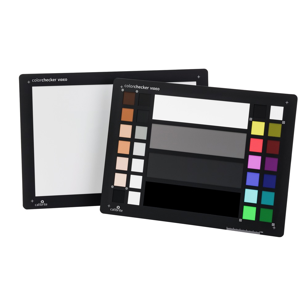

    The other option vould be to use a Calibrate Colorchecker on set – On a recent shoot, our DOP used the Calibrate Video, and that was really helpful for maintaining skin-tones in the edit.
    Although, we did not grade on set, as it was not that kind of shoot.
    https://calibrite.com/product/colorchecker-video
    Maybe experiment with using the Calibrate, including before and after Capture One adjustments?
