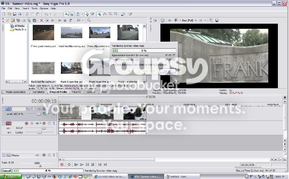

    Yeah i did use a widescreen template while rendering. The black border isn’t just on the sides its, on all sides of the video. The original video is in widescreen format and the rendered video is also in widescreen format.
    here is a screenshot of the video rendering with the border:
    https://i352.photobucket.com/albums/r340/frakattak/arrrgvegasstankz.jpg
  • Steve Rhoden
    July 22, 2008 at 2:14 am
    Kyle,
    From what i see,that is how the video would look during rendering.
    Nothing wrong there. The question is…does it look that way on the finished rendered video? and what media player do you view the finished video in?
