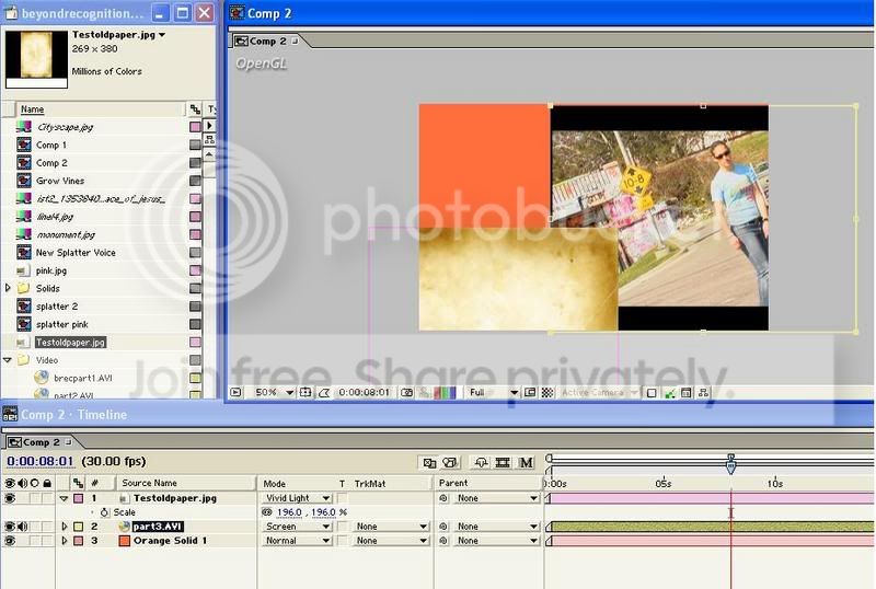

    Ok… Here’s what I’m experiencing. The layers you can see. I have set the blend modes to whatever “mutiply/screen” whatever I desire. But it has NO effect whatsoever on the composition. The only thing I notice is on the left of the layer title the eyeball is filled in with black, instead of being a regular eyeball like the rest of the layers. Maybe that’s because the blend mode is on. But why is it on and not working.
    Here’s a link to what I’m looking at please look!
    https://i33.photobucket.com/albums/d54/Tip345/workspace.jpg
    P.S. notice how the blend modes are on but it doesn’t effect the composition at all

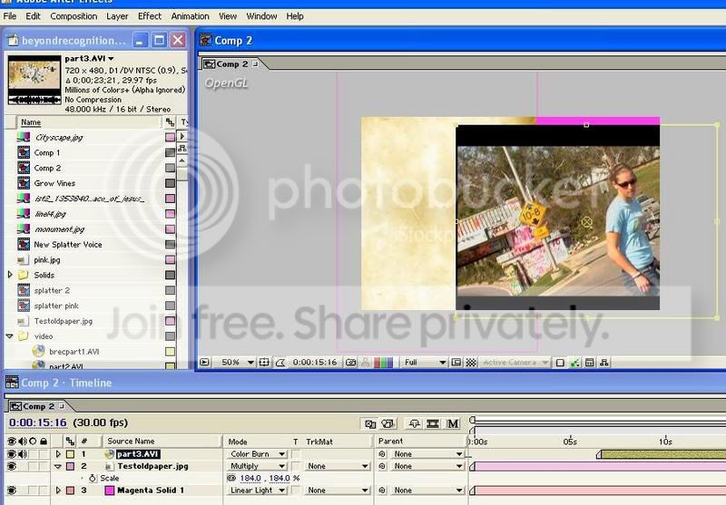

    Thanks Steve. Here is the Open GL turned off
    https://i33.photobucket.com/albums/d54/Tip345/opengloff.jpg
    Still nothing:( This is really upsetting me. Anything anybody?
    Notice how the little eyes are filled in black on the left side.
    Now the Open GL thing is set to “Off” but i tried it on every option on that popdown menu and nothing made it work
    Thanks.

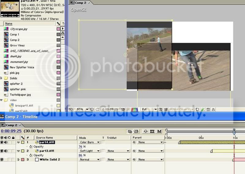

    https://i33.photobucket.com/albums/d54/Tip345/OPACOPENGL.jpg
    That’s with the opacities potted down, the Open GL switched to off…. Any More suggestions… Anybody?
    The Problem:: My blend modes don’t work. At all. I’ve tried different stuf (graphics and video) but they don’t work.
