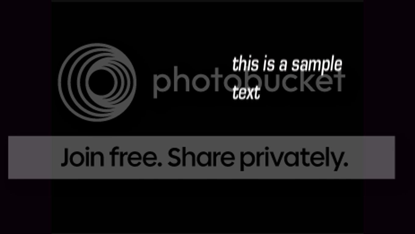

    i’m experiencing quite a weird interlace-jitter issue:
    a PSD, if imported straight to avid as a matte key, looks ok:
    avid matte key

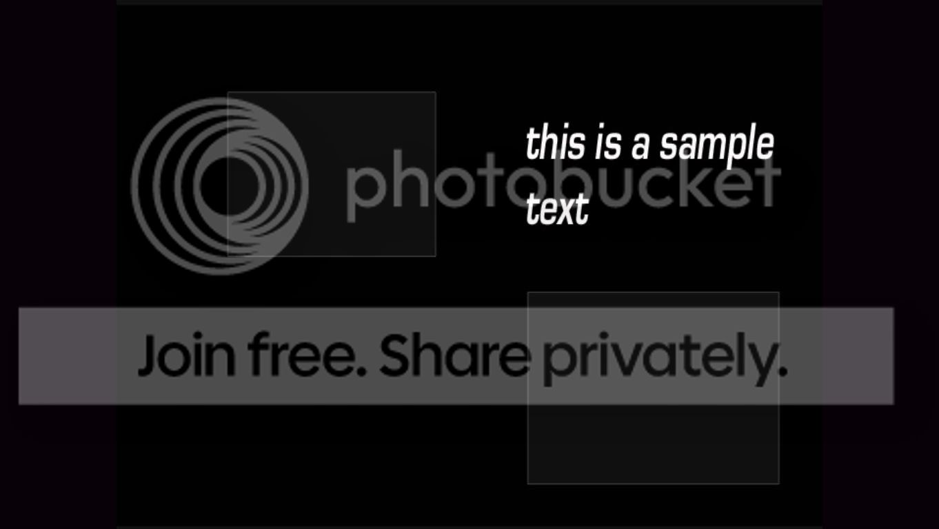

    if i put a boris effect on the track, then import the same PSD as the content of a 3d track, i get garbage:
    same psd via boris red
    the problem only shows up if i use the “highest quality” video setting on avid (green button), but it DOES exist in exported quicktimes as well.
    i noticed the problem first on a 23.976pA dvcpro50 project (that on avid is 30i), but now that i’ve played with it it seems that the problem persists across different project types.
    i’m on a pc MC 3.0 – the images above are screen grabs of avid’s full-screen playback with the “prt sc” function. ignore the squares, they’re on the alpha channel that the two apps handle differently.
