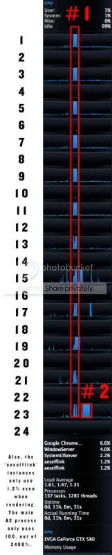

    I have a pretty solid computer but am very disappointed with how slow frame updates can be in After Effects. I am quite familiar with how to set up AE for RAM/CPU distribution, but maybe I’ve clicked something that is causing this issue.
    My system has 24 cores and 64 gb of RAM. I utilize 4GB per core, allowing for 8 AE cores. Also have CUDA enable for a gtx580 3GB. The OS is Mac 10.8.5 with AE Creative Cloud, fully updated along with the NVidia drivers.
    I’m attaching an image that shows 12 of my 24 cores jumping to action during a frame render, then one single core finishes the render very slowly.
    Another point worth mentioning is that I am rendering a frame for a map animation that uses a 20K jpg that is 10.7MB in size. There are a few images like this overlaying one another. The 10.7MB size is actually quite small given the resolution, but perhaps it is an issue… although I don’t know how that relates to AE simply not using the immense power at its disposal.
    Thanks in advance.
    Quick info on the image:
    #1 = what happened the first 10 seconds after moving to a new frame in the timeline
    #2 = another 30 seconds on one core only

    In my experience, multi-core renders only benefit certain types of renders. Some renders are computationally expensive others are more disk-bound and are bound by data transfer speeds, ie reads and writes from the source drives to the render drive.
    From the description you provide about 20k images and JPEGs it would seem that the graphics buffer might fill trying to load 20,000 pixels and composite that with another 20,000 pixels. Since JPEGs are compressed they still need to be de-compressed to be read and composited.
    My guess is that your test Comp is disk bound and not processor bound – which might explain why After Effects is only using 1 processor, this particular render won’t benefit from more, its not computation that’s slowing it down.

    Hi Ridley,
    RAM use went from 2.95GB to 5.4GB utilization during a frame render. One core was active at 100% for 40 seconds until the frame rendered. I have allotted 4GB of RAM per core, so that use is within those parameters.

    I have done a few things this afternoon to test ways to speed the render time:
    #1: I swapped .psd files in for the .jpg files and when I rendered, the time was pretty much the same. Negligible difference.
    #2: I removed a Trapcode Particular layer and the render was very fast. 3 seconds. Obviously, the 30-40 additional seconds of calculation are caused by this…. I then put it back in and lowered the particle amount by quite a large portion and the render dropped down to 12 seconds, which is far better, but I am still very confused as to why Trapcode only uses one core to run a calculation.

    So after a day of ‘foruming’ regarding AE not using the resources my computer offers it, the following is the result:
    Todd Kopriva over on Adobe’s Forum says:
    “There’s no further insight to give, other than perhaps to tell you that we currently have a large fraction of our team working on making all of After Effects behave better (i.e., faster) in this area.
    No promises, but we’re hoping to have something to show next year.”
    In short, Adobe is aware of this issue and is working to fix it. While I am super happy to hear that, I must add that it confuses me that the BG Renderer Script https://aescripts.com/bg-renderer/ for less than $40 is capable of utilizing 100% of my machine and AE is more often than not, lucky to break 50% on a render and 10% when working in-comp.
    Anyway, let’s wish Adobe the best and pray for sooner rather than later, b/c sitting at a computer for longer than necessary is just unnecessary.
