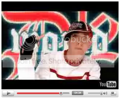

    1) CC Ball Action for the bank of lights. Decrease the default Grid Size and Ball Size as needed. CC Ball Action = Instant Jumbotron.
    2) For brighter brights see Andrew’s tut here, for 32 bit comps and the way he crushes all but the whites in a duplicate layer:
    https://www.videocopilot.net/tutorials.html?id=33

    Thanks, man! I didn’t even think of CC Ball Action!

    if you are using video in the ‘light wall,’ applying posterize prior to ball action to limit the number of colors may be helpful (those displays usually have a limited number of colors). posterize time could also be useful to mimic a lower frame rate. and glow could be useful if you didn’t want to go the 32 bit per channel route.

    Thanks, Kevin! I am planning on using video in the “light wall” and while I haven’t had a chance to get back to that project specifically, I was thinking that i needed to do exactly what your input suggested…the limited color palette.
    Thanks a bunch everyone!! I’m off in the right direction!
