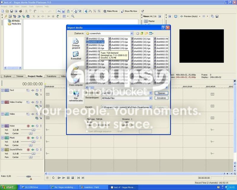

    Just as i thought the problem was fixed i faced another one. As you can see on the screenshot i enclosed below i can’t pick open still image sequence. What am i doing wrong?
    Jurgen.
    They say a picture is worth a thousand words…
    You need to get rid of the parenthesis in the file names. The files must end with just a number to be recognized as a sequence (e.g., “shot0002 01.tga”, “shot0002 02.tga”, “shot0002 03.tga”, etc. ). Yours end with ‘).tga’
    Use any batch rename program to fix this. I can highly recommend Bulk Rename Utility. I use it all the time.
