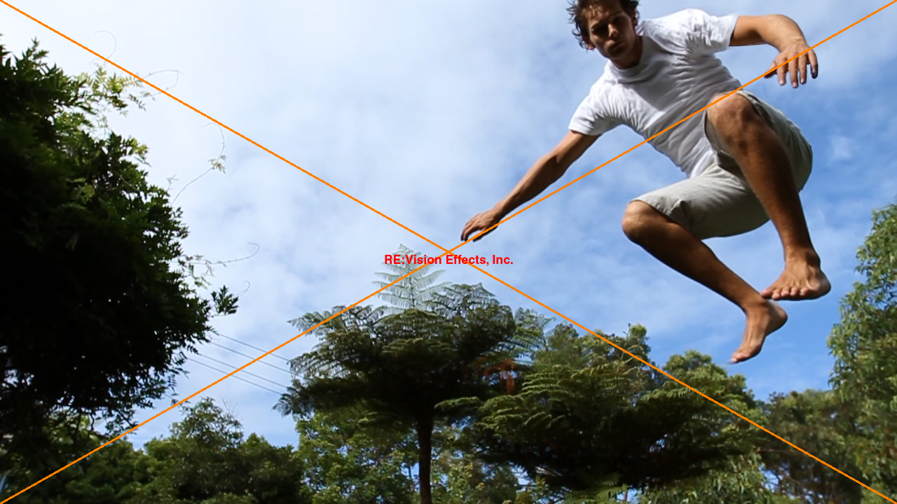

    Here’s a quick example using your footage:
    1) Output with no layer
    https://www.revisioneffects.com/bugreports/results/outputNoLayer.jpg
    You obviously end up with some misregistered fingers
    2) Output with layer
    https://www.revisioneffects.com/bugreports/results/output.jpg

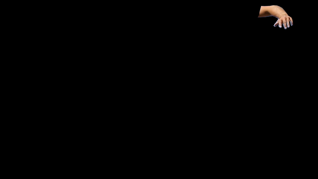

    I did a quick matte (looks like below) – could be tighter (right now in Twixtor I set Inv Matte Shrink to 4 as this is a sunday afternoon roto job 🙂 — you need to do that on the original footage without twixtor – but look first where Twixtor breaks and this will tell you what source time frames you need a matte where.
    3) Matted Foreground looks like this, we use the Alpha channel here
    https://www.revisioneffects.com/bugreports/results/mattedLayer.jpg
    To use such matte in FCP to separate foreground from backgound, you first need to make an animated matte (black and white footage… Where white are pixels of the foreground element), and then drop it into the FG Mask clipwell of Twixtor.

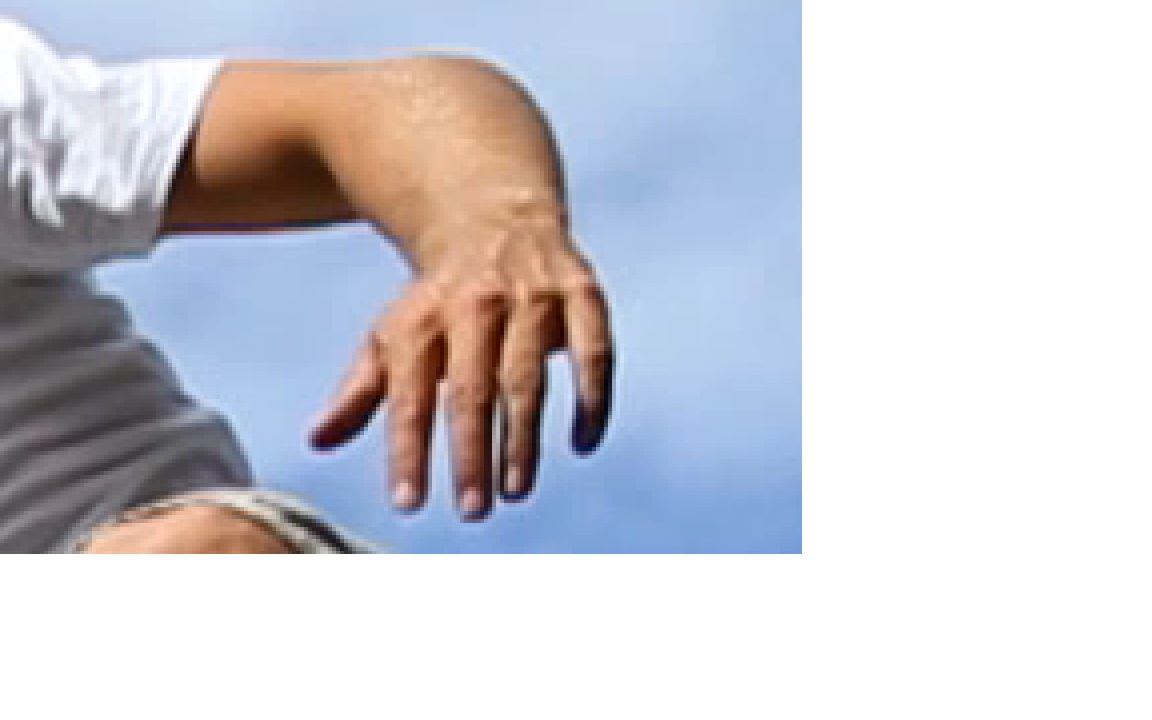

    4) Also note: The footage seems to be shot with some nasty auto-sharpness or something – look at the dark blue fringe – and the ghosting around everything – that absolutely does not help
