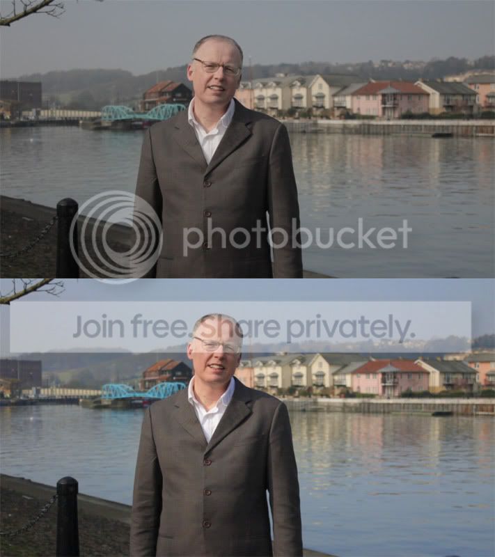

    I shot some footage on a sunny day, with a blue sky. But, now I’ve got to editing it the sky looks grey!
    I want to make the sky look blue-er. It doesn’t have to be a wonderful clear blue sky, just not look so depressingly overcast.
    I have done a bit of searching online and found a couple of solutions, but neither will work for my particular clip. Adding a feather blue solid doesn’t really work because of the shape of the sky and an awkward branch jutting out. And, because there is so much grey elsewhere in the shot it seems pretty impossible to mask it or key it out.
    Here’s a still so you can see what I mean: https://www.punchabove.com/IMAGES/Sky_Sample.jpg
    Any suggestions as to a suitable workflow, or can anyone point me to a tutorial that can help?

  • Kevin Camin
    March 17, 2011 at 5:17 pm
    I was able to correct your footage with AE tools and didn’t need to create any masks or mattes.
    The first issue with the footage is that is lacks contrast and that muddies the colors. Just move your highlight selector in Levels to meet the edge of the histogram. That makes a huge improvement.
    The next thing I did was use the Vibrance effect to push up the undersaturated colors. Vibrance is great because it leaves alone already saturated things like that bridge in the background and is more delicate on skin tones.
    The last thing I did was use the Selective Color filter and added blue in the Cyan and Blue channels. This gave a little bit more color to the sky without much effect on the talent.
    This is just one approach but it took me about 2 minutes to do.
