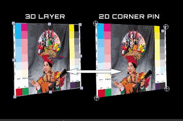

    [Navarro Parker] “Are there any clever expression tricks to convert a corner pinned 2D layer into a 3D perspective layer (Or at least a close approximation)?”
    The biggest problem I see with this is that it’s very very easy to create a 2D Corner Pin that does not match any perspective. Assuming that it does match some perspective the challenges then become:
    1) defining how near or far away the corner pinned layer is from the ‘camera.’
    2) figuring out the parameters of the camera based on (1).
    3) determining the scale, position and orientation of the 3D layer based on the corner pin data as well as (1) and (2).
    Maybe this is possible, but I have a suspicion that 99 times out of 100 your 2D corner pin will not match any perspective projection. At that point I wouldn’t know how to proceed. I’d assume some sort of heuristic method would work but that’s beyond my pay grade 🙂

    i have same situation i have a scene with plane corner pin which is tracked for mobile screen and i need a 3d null with position, rotation and scale with same screenspace of cornerpin if i attach a solid plane at 3d null.

    If you mask the footage so that you can 3D camera track the phone by itself, you can create a camera and 3D position data from it.

    Seriously, has anyone come up with a solution for this? I need to match a bunch of 3D text into static shots of a city … there MUST be a way, given 4 points, to calculate the focal length / position of a camera … no??
    Maybe some way to use the 3D motion tracker … ?
    I just know there is some math out there that would accomplish this.
  • Kalleheikki Kannisto
    August 24, 2016 at 6:23 pm
    The mathematical operation is called “decomposing a homography matrix” (no kidding) and it it certainly a complex one.
