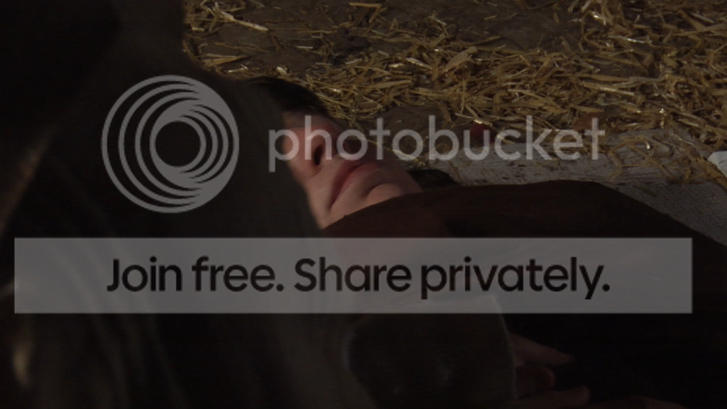

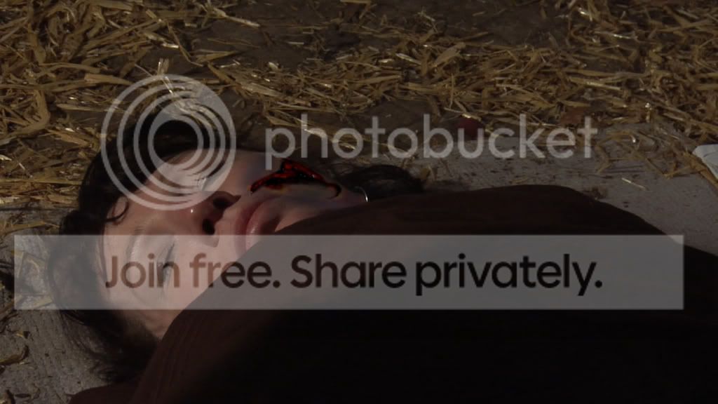

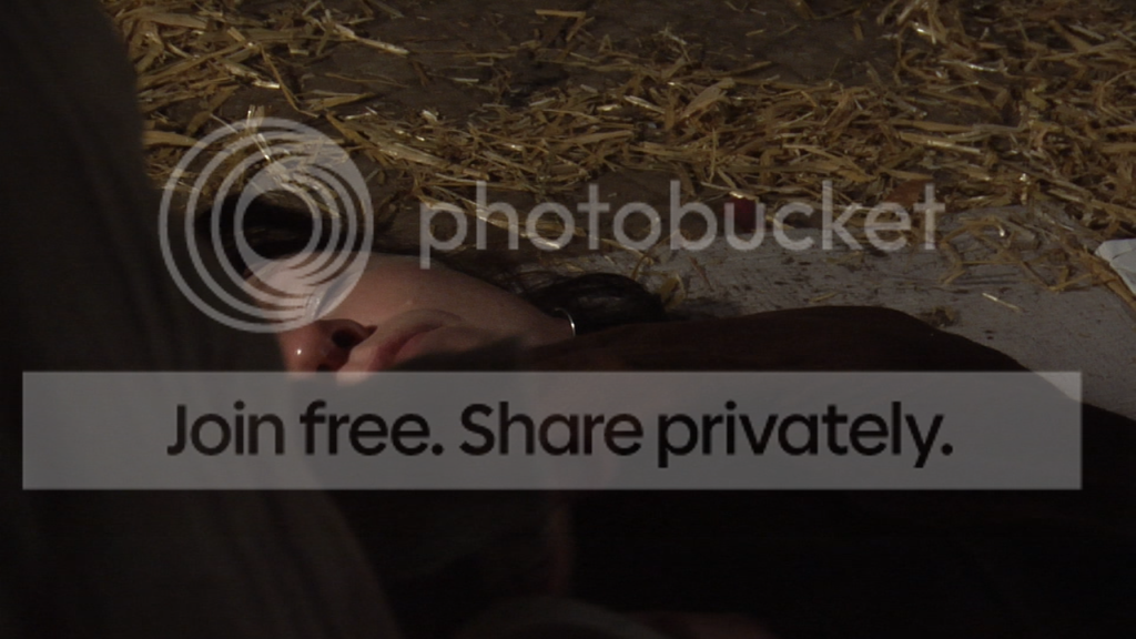

    Yes unless you are particularly skilled in that area, doing it frame by frame would be difficult to manage.
    What I would do is track the scar to her face. Apply the track to a null layer, and parent your scar to that null layer.
    Then put a mesh warp on your scar, set a key frame on the first frame she starts to turn her head.
    Then go to the frame where her head stops moving and warp the scar into place. The go the middle and warp that frame into place, same methodology as roto.
    The key is to find little reference points on here face, for example lets say the bottom left corner of the scar just touches a mole she has on her cheek, so then you know to warp the bottom left corner there in future frames.
    Good Luck!
