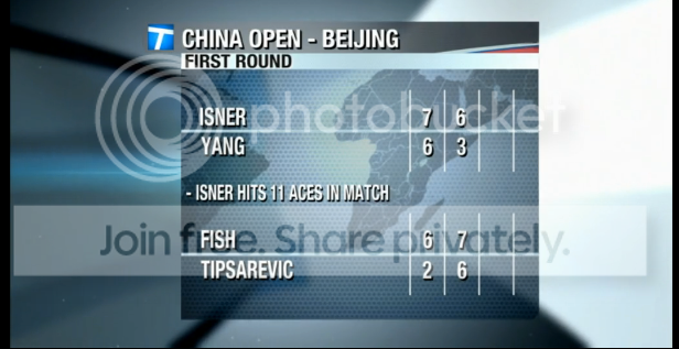

    I need to create a template for a full page scoreboard over pre-made graphics. This is an example of what I’m talking about: https://i26.photobucket.com/albums/c106/swany65/Screenshot2010-10-11at110837PM.png
    I only need to change the scores and names of the page, but keep them aligned to the background graphic. How would you recommend doing this without using 11 layers of the text tool?
    Would this be something better off in Motion? Thanks for anyone with suggestions. BTW, I was using Inscriber for this task but we are now moving over to final cut.

    Yeah, that’s a great job for Motion.
    Create a motion template, save it to the default location, relaunch FCP and type in the values.

    Motion template works like a dream for what I’m doing. But I’ve run into another issue you may know a workaround for. I need to enter my text for lower thirds, full page graphics and such in all caps. However, when turning on the caps lock key in Final Cut, I lose the ability to see updates I’m making because that render warning message disables my canvas. Any suggestions?

    I Found out what I needed to do to get all caps!
    Because I used that Motion template, I’m able to use the ‘all caps’ parameter on my Motion layer. That solves the problem. Now in Final Cut, as I enter my text in the Motion template in lowercase, it updates my canvas real time all in caps. I don’t need to get near that caps lock now!
