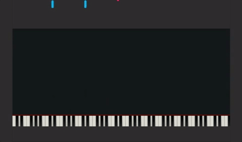

    Thanks for that tip! Seems super useful. However, I’m still trying to find a method that would be a big timesaver for the project. The way I’m picturing it is something like this:
    I’m guessing it would be better to visually see this data in rectangles, precomp’d and offset out of view (e.g. the darker area above) and then just animate the position all the way down, making it go out of view again. Or is this just not feasible? Thinking comp sizes here too as well as timing it with the keyframes.

    i still think i’d ty to work it out with particle systems… to have the particles rain down and hit the key as the it needs to be played, you’d offset the checkbox controls for the particle emitter/producer by as long as it takes for a particle to move from the top of the comp to the keyboard…. so if it takes a second for the particle to move, you’d offset the checkbox timing by one second. you could do that with valueAtTime().
    chk = thisComp.layer("activeLeftHand").effect("22")("Checkbox");
    offset = 1' // value in seconds
    if ( chk.valueAtTime( time - offset ) == true ) 100 else 0;
    also, once you know how fast the particle is moving and how far it needs to move to go from the top of the screen to the keyboard, you can create a custom particle that is the height that it needs to be if it moves one frame. ex: the particle moves 300 pixels in 30 frames, the particle should be about 10 pixels high.
    with the height of the particle set, you can also calculate the minimum birthrate that is required to have one particle be released for every frame to make a continuous line, thus minimizing the number for particles required. using the previous example, the birthrate would be 30 per second, so the ‘100’ i used in the expression would change to 30.

  • Shahid Raza
    November 2, 2017 at 1:32 am
    Thanks for your help Kevin, I’ve done my best with the particle systems method and I think it’s worked well.
    The timeToFrames wasn’t really working so I did the following:
    thisLayerNum = (thisLayer.name).replace(" Left Hand", "");
    chk = comp('MIDI Control').layer("activeLeftHand").effect(thisLayerNum)("Checkbox");
    if ( chk == 1 ) 100 else 0;
    And then moved the comp for particles system to the left, offsetting it enough in time.
    But the death size is too long, it doesn’t stop where I need it to.
    If you look at the top part of each note, it goes slightly over before the next note starts.
    This isn’t the case with the actual keyframes, but rather the particle emitter.
    How can I change this so that it has an abrupt end? Here are my settings:
    Thanks.
