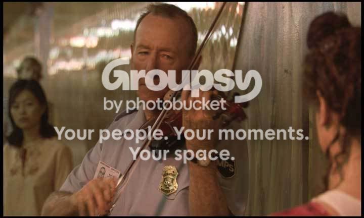

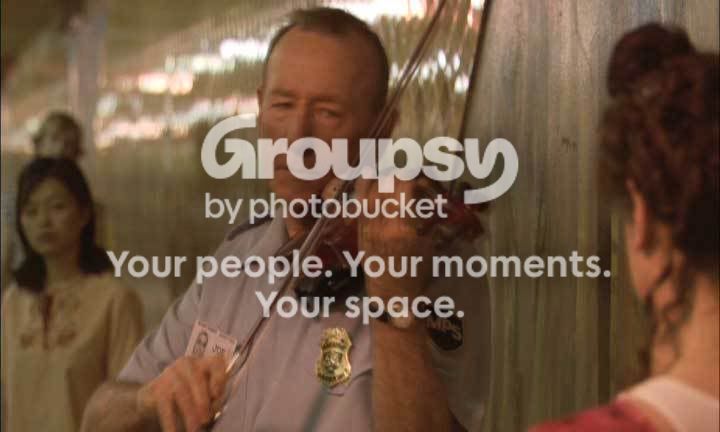

    here’s some examples:
    EXAMPLE 01a – FCP BLEND
    EXAMPLE 01b – MOTION FLOW majority better than FCP BLEND, but moving hand (lower hand) has issues
    EXAMPLE 02b – FLOW notice “6th finger” mutation on moving hand

    Howdy,
    Off-the-shelf Shake won’t provide a better result, as it uses the same optical flow (OF) tech as Motion and Compressor. This sort of artifacting is pretty typical for OF, as the algorithms can get spoofed by fast lateral motion, and they don’t necessarily understand the idea of foreground versus background objects.
    Some apps, like Realviz’s Retimer, have tools that permit you to manually correct the individual motion vectors, allowing you to avoid some artifacting. The latest version of Foundry’s Furnace plugins (which can be run in Shake) have a new motion estimation engine that is supposed to do a much better job at fixing this kind of “drag” where a faster-moving object pulls along pixels from nearby, but slower, objects.
