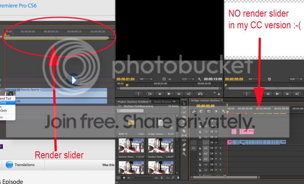

    https://i216.photobucket.com/albums/cc53/zymurgy_bucket/render-slider-missing-ae_zpsb31512ce.jpg
    The above link illustrates my problem but here goes… After adding text animation dynamically from Ae to Pr the preview has started to crunch and lag.
    No problem I learn just narrow down the render slider so you dont render the entire footage but… I cant find / switch on my render slider! I’ve zipped up and down the window nav ticking and unticking but still i dont get this little yellow slider which lets me render only a portion of the footage.
    How can i get it to appear (or stop crunching lagging previews) in the CC version of Pr? I’m going crazy with this one 🙁

    Right click on your Sequence tab and choose ‘Work Area Bar’ to switch it back on.
    It was turned off by default in the first version of CC, mostly because many editors found it quicker to set in/out points and create preview files in that range.
    But you can still use the Work Area Bar in the same way as you’ve been used to, by switching it on.
