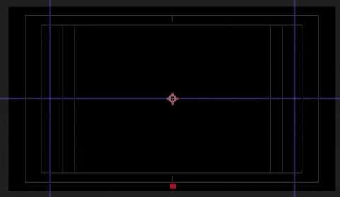

  • Vasyl Iskovych
    July 9, 2020 at 5:06 pm
    I can not use sourceRectAtTime () because the text jumps up and down, depending on the characters that are entered.
    And the position of the text, which should be located on one line – will be different, depending on the characters.
    I wanted to make sure that the text did not go beyond certain limits horizontally.
    I did this with a snap to null.
    But I would like to add the ability to automatically wrap text on a new line and shift the text up after a new line appears.
    I thought I would do this by restricting the text to text box, and add expressions to correct the vertical position, depending on the number of lines.
    https://youtu.be/6uE6iFjJ7Bs
  • Vasyl Iskovych
    July 9, 2020 at 5:10 pm
    Now, the text reaches a certain width, and begins to decrease.
    I wanted to make it so that the text reached the set width, and wrap on the second line.
    And it began to decrease when both lines reached this width.
