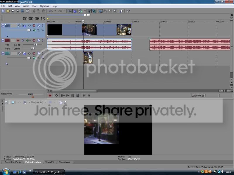

    The first is of the first video that I’m split screening:
    https://i68.photobucket.com/albums/i17/Musicmad_photos/screengrab1.jpg

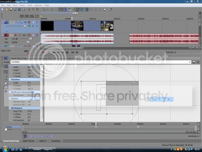

    And my pan/crop settings for it:
    https://i68.photobucket.com/albums/i17/Musicmad_photos/screengrab2.jpg
    The issue, as you may be able to see, is that despite trying the lock aspect ratio and size aboutcentre methods, the video clip won’t reach the top. I do render in widescreen anyway, but this looks like it isn’t even widescreen setting to be honest. Furthermore, when you split the second video, is there anyway of splitting the screen exactly, rather than just guesstimating where the split should be?

    You might want to try the masking method that I explain in this tutorial:
    Using a Mask to create a Split Screen effect
    This gives you more control.

    Yes, If you use Enable Snapping (second icon from the bottom on the left icon panel) you can click on the grid points and that will help you draw straight lines. You can also make them straight after you draw them by enable snapping and then move the points so that they snap to the grid. After that you can disable snapping and move sets of point together to keep the lines straight (i.e., selecting multiple points and then dragging one of them will drag all of them together).
