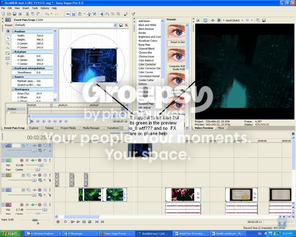

    Your comment in the image says that no effects are on but the image tells a different story. The Video FX icon above the preview window is green which indicates that you have added FX to the entire project on the main video bus. Check and see if these are affecting it.

    THX mate you were right! 🙂

    And make sure the split screen view is not always enabled.
