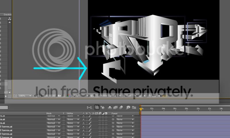

Posted by Juan Torres on April 27, 2009 at 6:10 pmHi guys, so I am still working on animating this piece of graffiti, I import all my layers as a comp into AE and they look pixelated. I figured Illustrator layers would be vectorized. Is there any way I could retain the vectorized clarity when importing into AE?

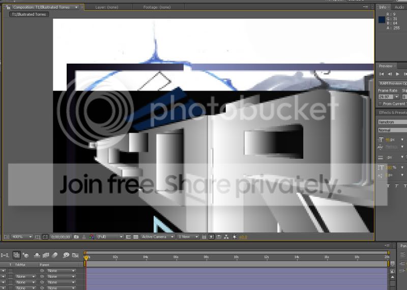

Philippe Lessard
April 27, 2009 at 9:03 pmLook like you maybe work on 0.9(720×480) aspect ratio comp with square pix image!try with 720×540 comp.Your screen capture tell me that you are 400% zoomed in maybe is just that?Otherwise continously rasterize should do the trick.

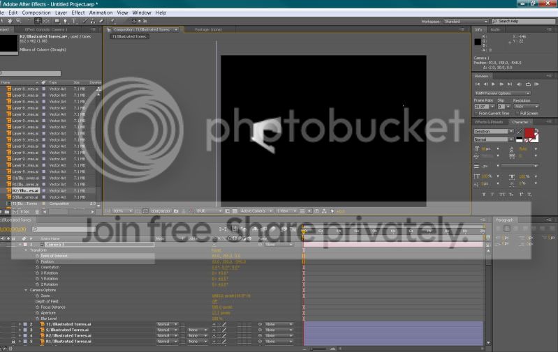

April 27, 2009 at 9:09 pmOupps! same answer.First put your comp viewer to 100% then turn your graphic in 3d with the 3d switch, create a new camera, then select the camera, then hit c 2 time then dolly in and you should see if your graphic still clean.
Juan Torres
April 27, 2009 at 9:29 pmThe first image below is in response to your double post in which I get the pixelated version on the z axis adjustment, the second is with the camera method, it also created a pixelated image of the layer, I did as you said, adjusted the layer into 3d then created a camera, selected the camera and hit c and c, then tried zooming and changing the position of the camera in which both created a pixelated view.

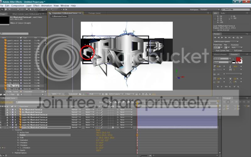

Juan Torres
April 27, 2009 at 9:49 pmI got it, thanks for the camera advice and the continual raster. Awesome help guys.
There is, the T nice and sharp. Ty times a million.
