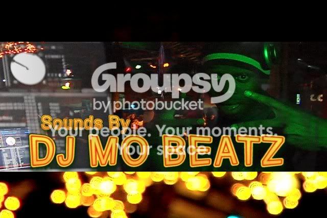

  • Tommie Green
    March 3, 2009 at 6:03 pm
    https://i70.photobucket.com/albums/i88/jaieillest/mobeatz.jpg
    In that picture, I would like the DJ’s laptop DJing program to be to the left and fade off into a video of him DJing on the right. The suggestion that I was previously told in this thread helped me to pull this image off, but the only thing is, as you can see, the laptop image on the left is in black and white… I would like it in color.
  • Mike Velte
    March 3, 2009 at 9:21 pm
    Describe what is in each track at that point. There is color on the left side of the screen.
  • Tommie Green
    March 4, 2009 at 2:40 am
    The color on the left side of the screen is the color of the image behind it. Here are the layers:
    4(top)-The image in the letterbox
    3-The title ‘Sounds By DJ Mo Beatz’
    2-The picture of the black and white laptop
    1-The picture of the DJ
    I WANT layer 2 to fade in opacity being 100% on the left and 0% on the right and for layer 1, I want the opposite.
  • Mike Velte
    March 4, 2009 at 12:01 pm
    Where is your track matte? Read about track mattes in the Help files.
  • Tommie Green
    March 5, 2009 at 6:59 pm
    Oh, I’m sorry. My track Matte is on a layer in between the footage of the DJ and the footage of his laptop, on layer two. I didn’t think to count it, sorry.
