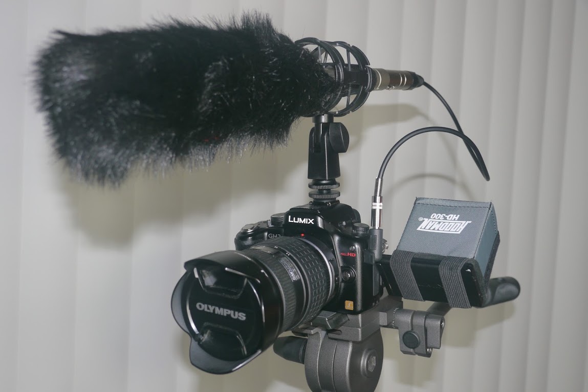

    On camera mics are OK for pickups, but most of the amateur mics with 3.5mm unbalanced outputs are not very good. I use a pro mic with a balanced XLR output – and an inexpensive little XLR to 3.5mm transformer cable to match the impedance of my camera’s input (see photo here: https://1.bp.blogspot.com/-6x2ziHgKUyQ/UOq2-ksrfPI/AAAAAAAAGXk/8i0Hrh9rLFw/s1149/P1010660.JPG)
    With this setup, I get really directional sound with very little noise introduced by the mic. To get away from these cameras’ noisy preamps and really clean up the sound, however, you will need a high quality mixer/preamp such as a Sound Design 442 or an SQN.
