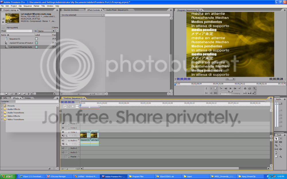

    So typically I re-encode the video into .WMV and that solves it… So I drop the file into After Effects… After Effects recognizes the length of the clip easy, but there is only ONE frame. Its a strange frame, multiple languages all saying “Media Pending? and then no video…
    I get this same problem in Final Cut, Premier, After Effcts, MPEGStreamClip says I have to buy something more from Apple to use MPEGStreamClip on it, or install QuickTime Alternative, and GSPOT tells me that I have the correct codecs installed for the video to play.
    Occasionally I’ve been able to get Windows Media Encoder to recode into .WMV for me, but typically it crashes or won’t even load the source video file.
    I have included a screenie of what Premier shows me when I try to add the clip to a timeline… I get the same single frame that Premier is showing when I load these clips into After Effects, or Final Cut, or anything…
    Screenie:
    https://i290.photobucket.com/albums/ll273/goblynn93/ScreenieHelpMe.png
    What the heck is my client doing to these videos? I can’t edit, I can’t fix, I cant’t typically do anything that I do to support clients when it comes to these clips!!

    Some of those programs will re-code the video but if you look at the screen shot I included… you see that “Media Pending” frame in the video window? I get that frame across the entire video. All NLE will show the true lenth of the video but none of them will show any of the frames other than that one. Or, like in the case of Windows Media Encoder all I get is black across the entire video.
    Playback of the video in media players works fine, and I don’t see that “Media Pending” frame anywhere in the video if I watch it Frame by Frame.
