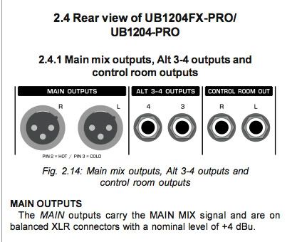

    [Mike Cohen] “This makes me think the output of the mixer is not line level, or a line level that is somehow incompatible with the camera’s version of line level. If the mixer is outputting -10db and the camera is expecting +4, could that be it? The manual does not make it clear what level the line level output actually is. “
    The output of the Behringer UB1204 is +4 LINE LEVEL
    Image below is from the USER MANUAL available on-line at
    https://www.behringerdownload.de/UB-Mixer_/UB-GROUP_2_ENG_Rev_D.pdf
    You definitely need to adjust the camera’s manual level controls to match the output of the mixer.
    FWIW, at least for checking… try the AUTO level setting on the PD-170. It will quickly give you a better idea of true input signal.
