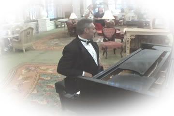

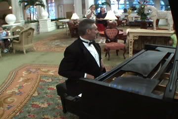

    Simply put the “inside” video on an upper video track (if you are putting it over another clip) and appy the “Mask shape” filter (set for Oval and adjust) AND the “Mask Feather” filter and adjust to the softness desired.
    You can make this:
    Look like this:
