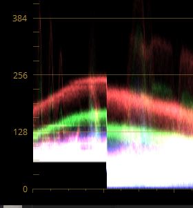

    i have footage from RedDragon 5kHD.
    when in the camera raw settings i set redlogfilm to redgamma2, the image is like the dop wanted and then i can control the all low and high levels.
    But with the footage, if i stay in redlogfilm and I apply a lut redlogfilm>redgamma2 then i can’t push the low level below around -64
    the problem is i have some footage in DPX in redlogfilm so i have to apply the lut to match them with the other footage but I can’t match the low level
    On the picture below, on the left on the scope we can see the footage with redgamma2 lut applied and on the right the same footage but the redgamma2 applied in the camera raw settings;
    https://i.ibb.co/7C3YDyY/Capture.jpg
    I’m sure there is an option i missed somewhere, if you have any idea that would be really great.

    i don’t see why peter should not treat red footage the way he does as redgamma2. and, as long as you are in an davinci YRGB project, the redlog-film-dpx footage with the lut should look nearly identically. color temperature, iso and the like aside, if it was shot differently, those parameters are “burnt in”.
  • Andi Winter
    December 27, 2019 at 6:58 pm
    ps: more details please. how do you apply the lut? what are your project settings. do you try to match before or after the lut?
  • Peter Brelan
    January 7, 2020 at 10:29 am
    thank you
    effectively it didn’t work when i tried to lower the blacks before the lut, but it works when i lower the blacks after the lut node. That small details killed me ☺

    Thank you Andi,
    the difference with the lut redgamma2 and the original redgamma2 is the low lights in the lut were limited, i couldn’t push them to 0.
    But I discovered I can push the low lights if I do it on a node after the lut. Strange but it works.
