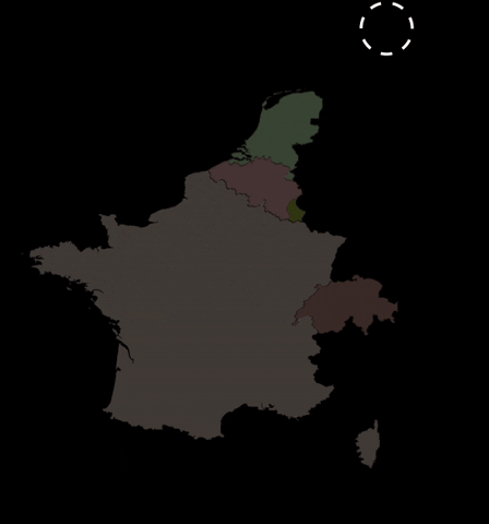

    imagine, your are going to control opacity of countries on a map with position of a null object.
    when position of null object achieves to the borders of each layer (country), opacity of country changes from 0 to 100 and then from 100 to 0 while null object is crossing the country layer.

  • Filip Vandueren
    May 19, 2016 at 7:42 pm
    If it were simple objects, you could get away with calculating the distance between the anchor points of your reacting layers and the Null layer.
    But since you gave the example of a map of countries…
    I think the best approach would be to use an expression that uses sampleImage().
    You can see if the point were the Null Object is is transparant or not ( every country is on is own layer and has an alpha channel), then use that information to drive the opacity of the layer.
    Here’s the expression:
    n=thisComp.layer("Null"); // make sure this is your Null !
    p=fromComp(n.toComp(n.anchorPoint));
    // do some fromcomp layer space transform in case the Null or country is parented to something else
    r=10; // the radius of the sample -> this will make the country fade in as you approach r pixels from it's border
    // make sure the radius is smaller than your smallest country, and larger than 0.5 px
    s=sampleImage(p, [r,r], postEffect = true, t = time);
    alpha=s[3]; // sample returns [r,g,b,a] between 0-1, we only need the alpha channel
    linear(alpha, 33,100); // convert alpha 0-1 to opacity 33% - 100% (or any other thing you want.)
