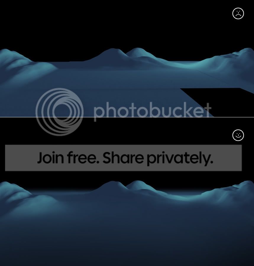

    i’m a newbie to c4d, maybe you can help me…
    i want to create a landscape scene, that is flat in the middle with a circle of mountains.
    i tried soft selection and minus z, but then i get a crater (caus i dunno how to limit to 0).. and i tried more landscape objects with a plate, but looks like crap.
    take a look at this pic, at the top is what i did in c4d, at the botton i fixed it with photoshop, to show what a want:
    https://i125.photobucket.com/albums/p73/4560815/c4dscene.jpg
    any idea or tutorial you can pass me?
    thank you very much, cheers,
    jason/cologne

    In this case, provided that you line up the landscape objects properly, I think you can eliminate those seams by placing the landscapes in a Connect Object.
    Personally I would do this sort of thing with subpolygon displacement instead of using the primitives. In this example I’ve created a quick circular landscape by way of the layer shader, which works similar to PS. https://www.3danvil.com/tutorials/circular%20mtns%20displace.c4d
