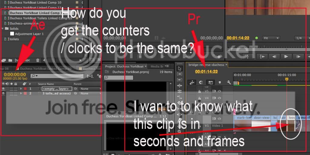

    Above link illustrates my problem but here goes…. When in Pr I need to measure the length of time of a clip and then open an Ae composition with exactly the same time duration.
    Now so far ive been doing it what feels like the hard way. For example the timeline footage circled in the above link starts at 1:14:12 & ends at 1:17:22 I then subtract one from the other and get 4s 9f (25f / s), hope i got that right. So then I jump over to Ae and open a composition for that duration. This does the job but it feels too long.
    Yes Ive toggled through different time presets such as 46+29 no idea what this means 🙁 But going back to my original point how can you get counters to match across both packages, would be great if i could zero the Pr counter at the beginning of a clip but its an accumulated time hence the subtraction sums I have to carry out.
    Well hope Ive explained this well enough, its difficult to articulate but fingers crossed the screen grab helps.
    Any insights welcome 🙂

    To quickly see the length of a clip in Premiere, move the scrubber over the clip and press the “f” key on your keyboard. This will put the clip in your preview window with in and out points set. The counter on the lower right of the preview window will be the length of the clip.
    EDIT: I actually just checked and you can hover your mouse of the clip in your timeline and it will give you the duration as well.
