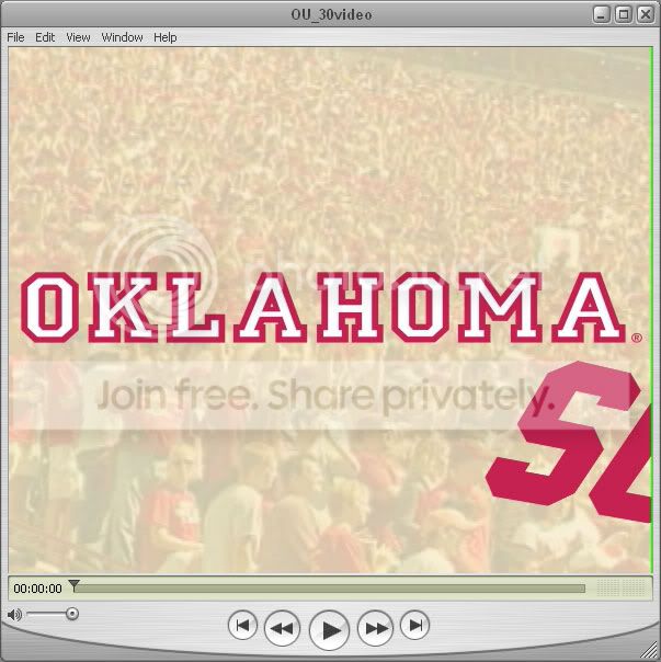

    I’m exporting out to QT H264 and I’m getting this green line on the right side.
    Mr. Green Line
    I’m exporting the project to a resolution of 587×480, but I’m not sure why that would cause this green line. Is there a way to fix it without changing the resolution?

    [aplusjimages] “I’m exporting the project to a resolution of 587×480, but I’m not sure why that would cause this green line. Is there a way to fix it without changing the resolution?”
    No. You are using exactly 1 pixel to few. For MPEG-4 and its derivatives like H.264, all resolutions must be based on multiples of 4. Therefore AE will fill “crooked” resolutions with zero-valued pixels (which show as YUV green) to make them compliant to specs.

    Mylenium,
    Thanks for the info. I made the resolution 588×480 and it reduced the green line, but it’s still there. So I tried it at 584 and 580 and I still get a thin green line.

    Did you try multiples of 16? 576 or 592?
    (excellent explanation, Mylenium)
