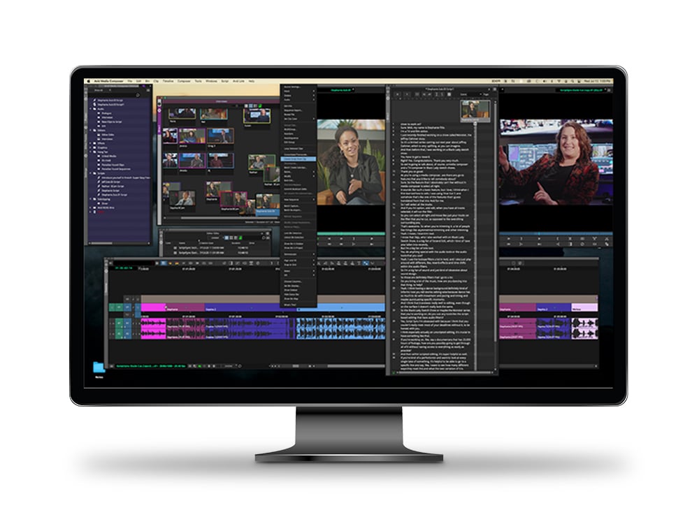

    Although I have not worked with it, yet (have got the licence), Avid Scriptsync might do what you are looking for:
    https://www.avid.com/products/media-composer-scriptsync-option
