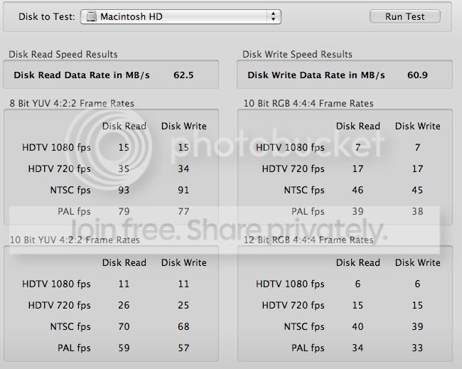

    I ran the BM Disk Speed Test. I’m just not sure what all these numbers mean?
    Can someone please explain to me what the following information is telling me?
    Do the results mean that I’m good to go with uncompressed HDV via HDMI?
    The first is my OEM Mac Hard Drive. The second is my 3TB RAID set.
    Blackmagic Disk Speed Test Results
    Date: 2009-06-07 22:10:23 -0400
    Mac OS X Version: 10.5.7
    Physical Memory: 2047 MB
    QuickTime Version: 7.6.2
    Read Speed: 62.5 MB/s
    Write Speed: 60.9 MB/s
    Date: 2009-06-07 22:13:26 -0400
    Read Speed: 314.9 MB/s
    Write Speed: 310.0 MB/s

    your RAID will be too slow for 1080p and right on the bleeding edge for 720p but no problems for any SD images. You need a minimum of 4 drives for HD so get an external solution with a really good controller card. check out https://www.caldigit.com HD Element or https://www.g-technology.com G-Speed eS.
