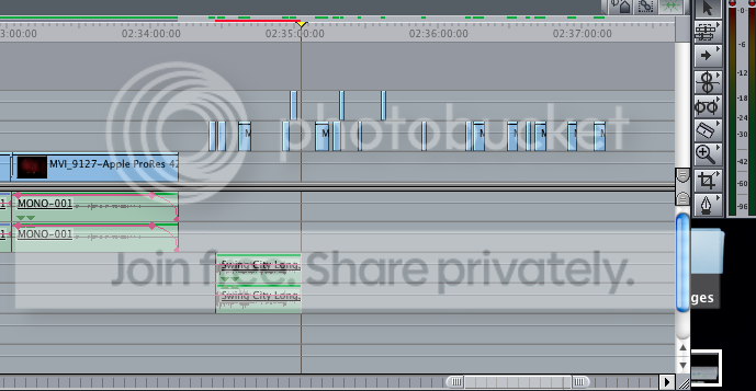

    I’m working on a a two and half hour looong play! 🙂 I am usually editing 30 minute wedding videos and over the past several days I’ve been having problems rendering audio files that I import.
    Mp3 and caf files both indicate that I need to render them, however, when I do render nothing happens. I get no error message or any indications that something went wrong…it just simply doesn’t render it. I must be missing something silly and it’s probably staring me in the face, but I can’t quite figure it out.
    I took a screen shot of the timeline including the caf file that won’t render.
    https://i1177.photobucket.com/albums/x360/StoriedProductions/Screenshot2010-12-11at22257PM.png

    Have you tried converting those MP3 and CAF files to AIFs? I’ve never encountered this problem since I always convert audio to either AIF or WAV so I’m not sure that’ll solve the issue you’re having, but it’s definitely worth a shot since most pro video software doesn’t deal well with media that’s in delivery formats instead of editing formats.

    Correct. Make sure also that your sequence and the aif files are 48khz sample rate. Your sequence will say 32 bit which is normal but the clips must be either 16 or 24 bit.

    If you converted to AIF at 32-bit float, they will still need to be rendered. Like Michael said, make sure they are 16 bit or 24 bit. Also, under your render selection settings, is the audio “needs render” checked before you hit cmd-R? Those settings seem to confuse people a bit, you check on the color of clip you’d like rendered. When you do, it will have a check mark on it. Then when you hit cmd-r, it will render any type of render color that is checked.

    Don’t use MP3. Convert.
    Remove mp3 from timeline.
    Add aiff.
    Copy timeline into a new timeline to get rid of corrupted render stuff.

    I’m WAY late on the reply, but this worked & you’re rock awesome for taking the time to give advice. Thanks!
