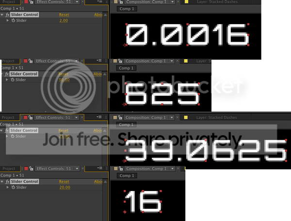

    Found this during a Google search and I’m getting odd results.
    I have a slider set to “50.00”, but the expression is displaying “125” (no decimals or trailing zeros). I set it to “15.00” and I get “3.375”. I set the slider to “20.00”, and it displays “8”.
    I realize when this was first posted, everyone was on v6.5, not CS6. Has expressions changed that much?
  • Navarro Parker
    November 29, 2012 at 2:48 am
    This expression does not handle decimals under CS6. It rounds to the nearest whole number. Could you possibly modify it to work with current expressions?

  • Navarro Parker
    January 1, 2013 at 12:50 am
    That’s so weird. Here’s what I’m getting with CS6 11.0.2

  • Navarro Parker
    January 1, 2013 at 1:12 am
    Yeah, but then you are losing the leading zeros from the original expression. (but I never got it to work)
