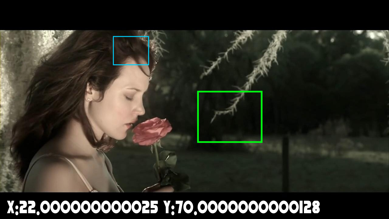

    My composition is 1280×720.
    preview here: https://optika-petru.cz/prev.jpg
    I have two rectangles: small (blue one) and BIG (green one) and need magnified copy of part of image which is in small and display it in BIG magnified.
    I need it dynamicaly – if small is moved, display dynamicaly its magnified content in big, and if big is moved its content remains same.
    I tried to parent adj. layer to BIG rectangle.
    In Adjustment layer is effect magnify.
    And I tried to control Magnify center point by expression, which doesn’t work well.
    This expression is Try-fail.
    Maybe it’s impossible to do it this way, and somebody know better way.
    So if somebody know how to solve it, i will be glad for some advice.
    Sorry for my english, it’s not my native language.
    x = thisComp.layer("small").transform.position[0];
    y = thisComp.layer("small").transform.position[1];
    this_point = thisComp.layer("small").transform.position;
    that_point = thisComp.layer("BIG").transform.position;
    //diff = thisComp.layer("BIG").transform.position[0] - thisComp.layer("small").transform.position[0]
    delta=sub(this_point, that_point);
    mag = effect("Magnify")("Magnification")/100;
    delta = delta * mag ;
    [x+delta[0],y+delta[1]];
    //[x,y];
    //[x*mag,y*mag];

    I’m not sure if I follow correctly, but the small square is magnifying and the big square isn’t? Is the magnification happening only in the small square?
    What I’ve always done is create two layers for this kind of thing. One layer much bigger than your canvas (hopefully large resolution) and a second layer where you’re animation takes place. The small square that magnifies will reveal the much bigger version of your image. So you’d have to create a track matte over the big version of your image that follows your square for magnifying.

    Thanx for your reply.
    But this is not what i want.
    I need seůect by small rectangle area, which has to be magnified, in this rectangle image remains same, its something like selector.
    And this selected area i need magnified in big rectangle.
