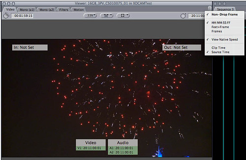

  • Craig Seeman
    February 14, 2008 at 2:58 pm
    This is screen grab from FCP 6.0.2.
    Note in upper right it shows as Non Drop Frame.
    Note in time code display in bottom center of image the time code number of 20:11:00:01, a number that should NOT exist with Drop Frame Time Code.
    BTW in Quicktime the above number does go from 20:10:59:29 to 20:11:00:02 as it should but Quicktime (as I noted previously) show the NDF Flag.
    What I’m seeing:
    Quicktime shows correct DF numbers but flags as NDF incorrectly
    FCP shows NDF numbers instead of DF and flags as NDF incorrectly
    Shooting in 1080p30 should be DF.
