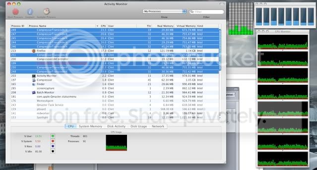

    Update: it seems that I had “use unmanaged services” checked when I submitted the compression to “this computer”. This opens 8 instances of compressor to use the 8 processors, but in activity monitor those instances are peaking at about 22%! Heck, half the time they’re using less CPU power than Firefox is. =P I’m I interpreting this correctly? Can anyone tell me what I’m doing wrong?
    Here’s what activity monitor looks like:

    I’m presuming you are talking about a virtual cluster here (on your Mac alone) and not distributed processing (using multiple computers on a network).
    When working on a virtual cluster, you need to balance your system RAM against your processors. For better performance, each processor in your cluster should have at least 1Gb of RAM available to it.
    From our experience and testing, don’t assign more than 50% of your processors to the cluster, unless you only have a dual core procesor (in which case, assign both!). Remember, however, the 1Gb per processor RAM requirement!

    well for one, you need 16gb of Ram minimum.
    thats 2gb per core.

    Ahhh, thanks Colin, that makes sense. Yes, I was attempting to set up a virtual cluster on my machine. I spent all my time looking up how to setup Qmaster and I never looked into the RAM requirements.
