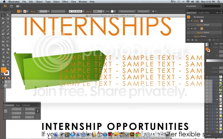

    I want the orange text to wrap around the sides of the green banner without touching it:

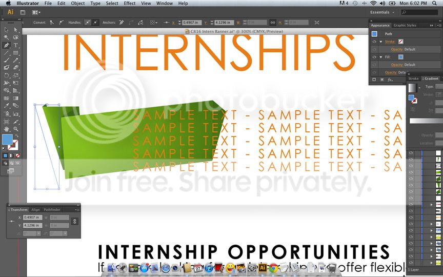

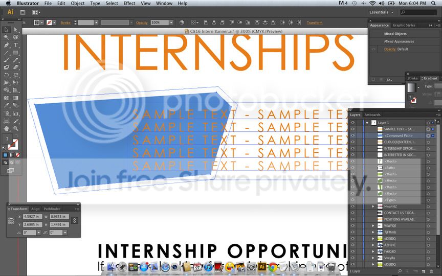

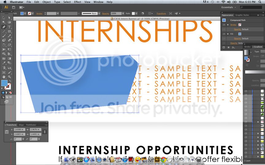

    So the first thing I did was start by using the pen tool to create an object around the green banner (I planned to delete the object once the text wrapped around it):

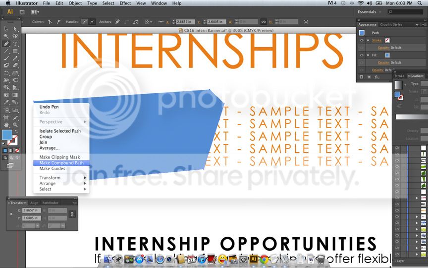

    When I’m done connecting the points, I right-click the object and select “Make Compound Path”

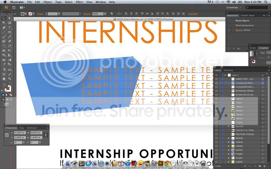

    Resulting in this:
    I made sure both the text and object layers were arranged in the front and the text layer was OVER the object layer:

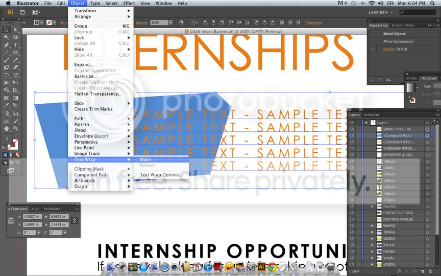

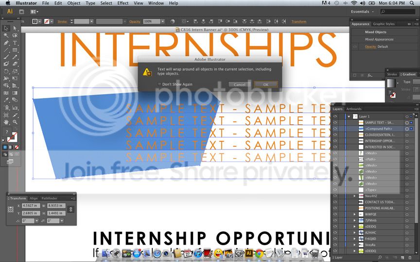

    I did Object > Text Wrap > Make
    I click ‘Okay’
    And instead of the text wrapping around the object, I get this:
    What am I doing wrong? Thanks CreativeCOW Community!
