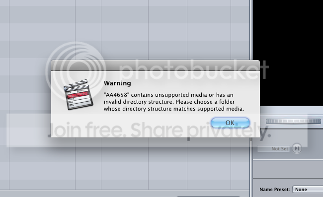

    Hi everyone, first post here and I might be at my wit’s end. I shot over 60gb of footage using the Canon XF300. My settings were for broadcast television, cards initialized (X400 Transcend CF cards, which I have used previously), etc.
    After the shoot when I attempted to capture the footage I was prompted with the error:
    “‘AA4658’ contains unsupported media or has an invalid directory structure. Please choose a folder whose directory structure matches supported media.”

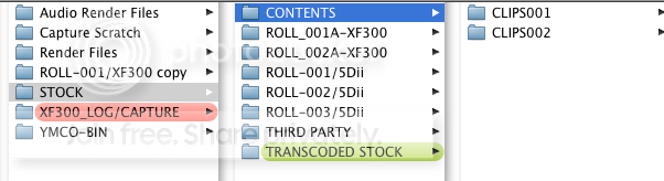

    The structure: “CONTENTS>CLIPS001”, etc.
    I’ve tried log & transfer, log & capture, premier, streamclip; IMPORT>SONY XDCAM. Importing it through the XDCAM plugin nearly worked except my audio would slip out of sync.

    You need to first download and install the Canon XF Log and Transfer plugin. Google it to find it. Then you use Log and Transfer to bring in the footage as ProRes

    Thanks for the quick reply, Shane. The error has disappeared but the footage is still invisible to FCP 7. For some reason it is not recognized. Any ideas why this would be?
