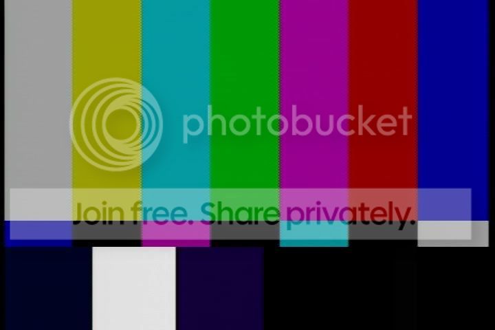

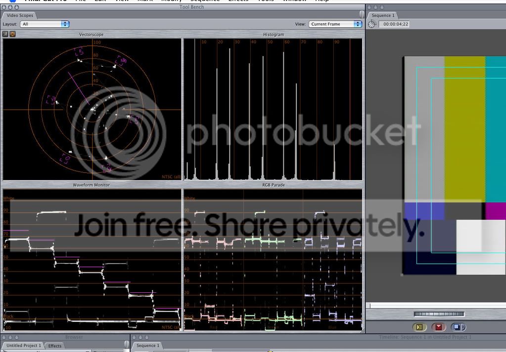

    Bob, thanks for responding. I’m sorry for being so vague. Unfortunately the only images that I can provide you with are a screenshot of FCP’s scopes with the bars coming through an AJA IO (Standard Definition), and a capture of the bars from FCP. The only means of actually getting a shot of my scopes would be using the crappy camera on my phone, and I don’t have any means of getting the image off of the camera while I’m at work. I would be happy to upload pictures later at home, if you think that it would help.
    We use three Ikegami HC-D57W cameras. We are a composite operation and strictly SD.
    Here is the AJA capture of the bars:
    Here is a close-up of a portion of the bars:
    And here is a terrible close-up screencap of the bars with final cut scopes up:

    Well my friend, welcome to NTSC video. This is commonly called NTSC chroma crawl. Back in the stone age (before Beta VTR’s were invented, and people were using composite video switchers and VTR’s), this is what everything looked like. And then the Sony BVW10, BVW15 and BVW40 came out (soon to follow by the BVW75, PVW2800, and the infamous UVW-1800). And LO AND BEHOLD, people saw ANALOG COMPONENT VIDEO, and the “ringing” that you see above in your video between GREEN and MAGENTA was GONE ! And guess what – it’s gone in SDI (which is serial digital component), and it’s gone in HD-SDI (which is HD serial digital component).
    The “ringing” or jagged lines that you are seeing come from NTSC encoders that take the RGB signal and convert them into a composite video signal. When component video is used, you DONT GET THAT RINGING (or jagged lines). ITS ALWAYS BEEN THIS WAY, before AVID and FCP were even a thought in peoples minds.
    You now understand why CAV, SDI and HD-SDI are the prefered way to work, and composite video is totally useless in 2008.
    SO, how do you make a composite operation look better – you don’t. Faroujda Laboratories spend decades working on products to improve NTSC composite, but the world changed, with new formats. When you watch TV at home, your local news TV station has all modern equipment, so you are used to looking at much better images that what you have at work.
