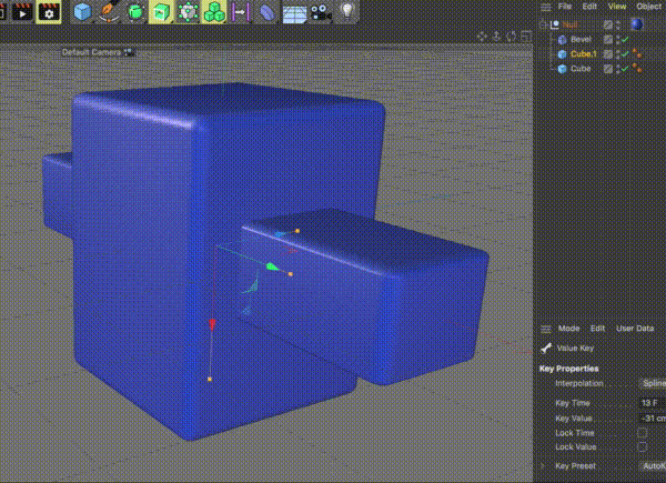

    Hi, I’d like a bevel deformer to affect the join between 2 intersecting objects:
    so I can then animate them:
    Is this possible without melding the 2 objects together into 1 polygon? I’d also like to try it with the subdivision surface
    Thanks

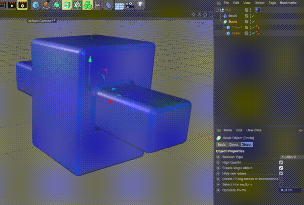

    There needs to be something in place to define where they intersect and the relationship between the two objects.
    That’s what you can use the Boole object for:
    14097_bevelatintersection.c4d.zip

    Fantastic, thanks Sam, that works:
