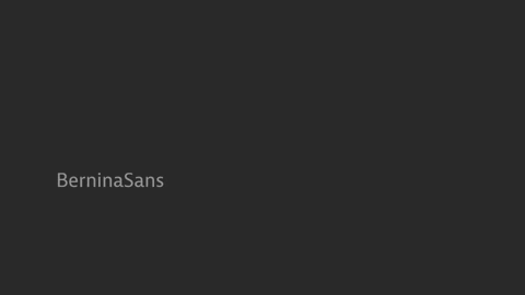

    FYI, a quick proof of concept ☺
    using Bernini Sans Regular / Narrow / Condensed / Compressed
  • Filip Vandueren
    July 16, 2020 at 8:02 pm
    Source:
    txt=thisComp.layer(1);
    w=txt.sourceRectAtTime(time).width;
    if (w<640) {
    f = "BerninaSans";
    } else if (w<715) {
    f = "BerninaSans-Narrow";
    } else if (w<800){
    f = "BerninaSans-Condensed";
    } else {
    f = "BerninaSans-Compressed";
    style = createStyle();
    style.setText(txt.text.sourceText.value + "\r" + f).setFont(f);
    Who knows, in another 10 years After effects might support variable Fonts, then another 10 before we can control them with expressions 🙂
