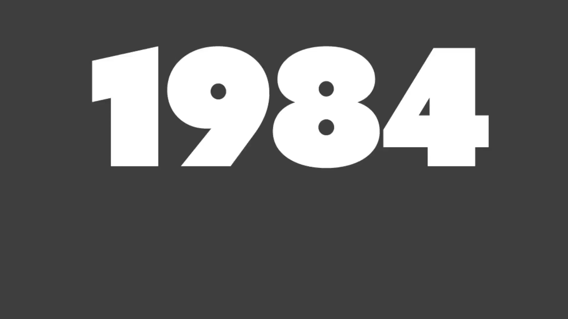

    I have spent days researching this:
    I have a circle with 40 numbers (years 1984 through 2024) equally distributed around its perimeter.
    I can keyframe this circle of numbers to:
    Rotate -9 degrees for 12 keyframes;
    Stop and hold rotation for 24 keyframes;
    Then repeat from last rotation value to continue 360º of the 40 numbers.
    I am using a null as the control layer but cannot cobble together an expression to achieve this using valueAt Time etc.
    Thank you for any tips or articles you can share.
    Example: https://motionmission.wistia.com/medias/n3m55rl74f
